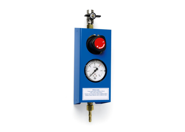

Covered gas point of use with manual valve, pipeline regulator and safety device
With a steel body, these blocks are particularly intended for industrial applications, boilermaking and mechanical welding workshops. They are also advised in training centers and other educational institutions. Supplied as standard with a SECURTOP 665 flame arrestor, shut-off valve, 100% tested and degreased in accordance with EN560 and EN ISO 5175-1 standards.
  • MODULGAS is compsed with : Inlet connection : G3/8" female straight; Shut-off valve; Inlet filter between the regulator and the shut-off valve; regulator with captive handwheel; pressure gauge or column for checking downstream pressure or flow (depending on model) andd safety device against backfire model SECURTOP 665 (OX and FG)
  • Version for Ar / CO2 available with flowmeter or mano-flowmeter
  • Outlet connection with hose tail
  • Protective panel in lacquered and reinforced sheet metal (1.5 mm thick) with profile designed for simplified wall mounting
  • Gas identification label
  • Drilling jig supplied with user manual
