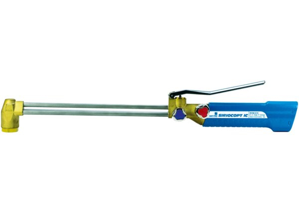

A handle that changes everything. Cutting torch with mix in the nozzle, Could be used with Acetylene or Propane depending the nozzle.
SIRIOCOPT is the ergonomic and innovative cutting blowpipe designed and produced by our Verona Plant. This patented design makes it possible to propose a new generation of manual fl ame equipments. SIRIOCOPT range is an international range available for 3 types of cutting nozzle (G1, IC and H1F) and thanks to the inlet quick coupling (QUICKMATIC II), requirements of the local standards are met. The advantages: Easy to install with quick connection; Ergonomic design to facilitate preemption; Free rotation of the connections and hoses; Blowpipe perfectly balanced in standard version. Benefit for the user are : Better handling: the lever for the cutting oxygen is fully integrated in the handle in cutting operation; Better maneuverability, with a limited torque effect of the hoses; Possibility to connect QUICKMATIC II with integrated safety devices close to the handle.
  • Durable materials: Aluminum handle, Triangle pipe position.
  • Quick inlet connections: designed to be used with QUICKMATIC II.
  • Protection of inlet inside the handle to avoid being damaged.
  • Weight: 1,1 Kg in G1 version 500 mm length.
  • Cutting Capacity up to 300 mm in IC & G1 version (150 mm in H1F).
  • 100% of SIRIOCOPT are tested in pressure and with fl ame lightening before shipping to eliminate risk of leakage and to guarantee its performances.
  • Designed and manufactured in Europe in our Verona factory.
